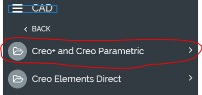

You are in the wrong forum.
PTC has two CAD systems:    Creo Parametric    and     Creo Elements Direct.
Which makes it confusing.
More, for Creo Elements Direct:
- The 3D software name is Modeling, and
- The 2D software name is Drafting.
For Creo Parametric, use only this tab:
You should move your post to this community to have a better chance to get an answer.
