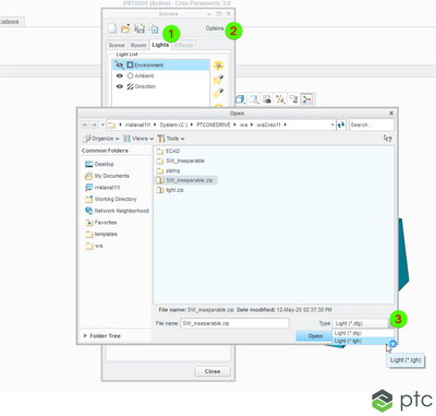

According to the PTC documentation, this is supported. I am not able to get this to work in Creo 7, 9 , or 10.
Is anyone able to confirm that loading a light file works for them? It is possible my light files are corrupted in some way, if someone has a sample light file they can post here, I will try it. I have included one of my .lgh files for reference.

Like @MartinHanak hinted, the file is old and dated from Pro/ENGINEER 17.
I gathered an internal information that the support of lgh file has been discontinued in 2015.
Regression tests reveal that support is active up to Creo 3.0.

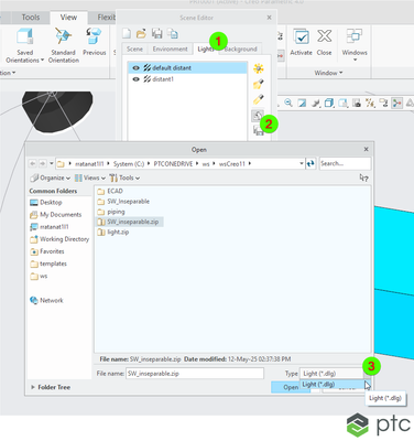

Starting with Creo 4.0 only .dlg files are supported :

just comment ... your file contains following line. I guess such file is not compatible with Creo 7, 9 , or 10.
#Pro/ENGINEER  TM  Release 17.0  (c) 1988-96 by Parametric Technology Corporation  All Rights Reserved. 97045
I saved lights in Creo 10.0.6.0 and attached it to this reply ... lights_Creo10.dlg.

@MartinHanak Thank you for posting the .dlg file. I was able to load this file in Creo 10. So the .dlg format is valid but the .lgh is no longer supported. I will be opening a case with PTC to get the documentation updated.
