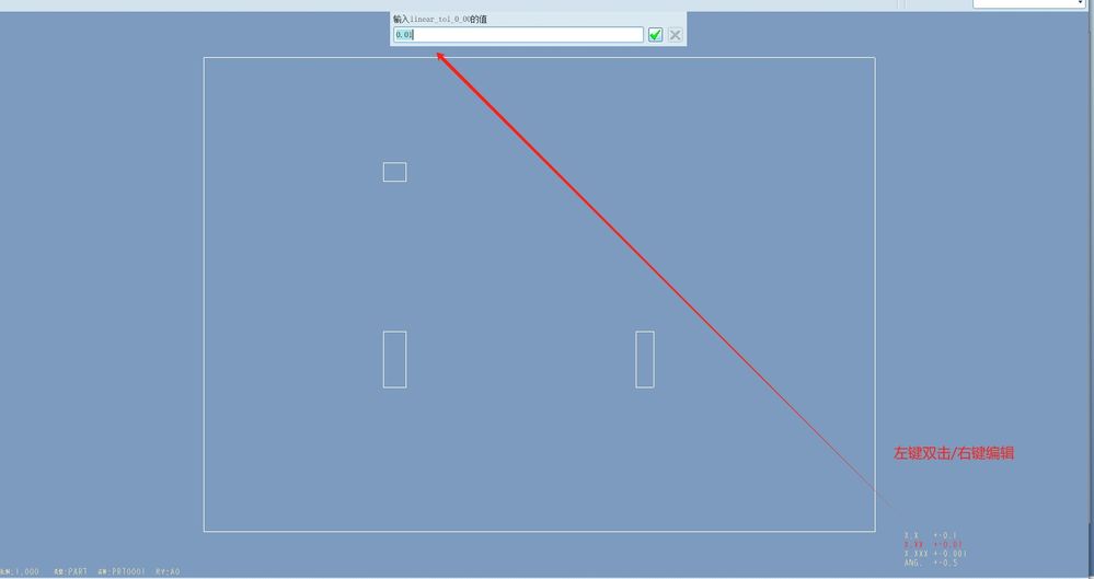

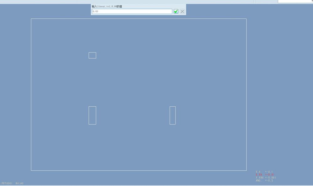

Thanks, I got partial answer that the tolerance table annotations cannot be deleted.
To be specific, I need to know whether the general tolerance table in the right bottom corner can be modified as per our customized requirement. ???
Default : x.x +- 0.1; x.xx +-0.01 ; x.xxx +-0.001 ; Ang +-0.5
Example custom required : x.x +- 0.2  ; x.xx +-0.025  x.xxx +-0.002 ; ANG +-0.2
StephenW
(To:Karthik_1)
Config.pro options:
These options apply when the part/assembly file are created. Changing these options will not change existing parts, only parts that are newly created.
linear_tol
angular_tol
