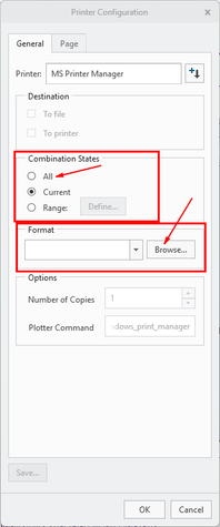

Yes with modifications suited for MBD. The output would be a print file say .pdf My suggestion is to Create a Trial Run before using the 2D output. In the meantime, you should explore .pvz files. "xxx.pvz" files are more powerful and is specifically tailored for MBD.
