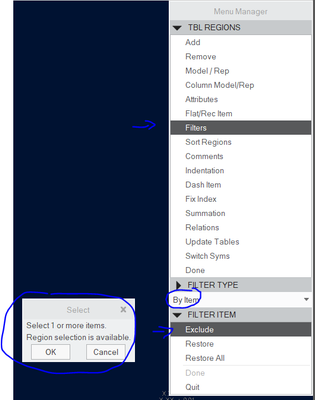

In creo how do you make a part within an assembly a reference part. What I mean by this is I want to put a part in an assembly, but I only want it to be in the model, not the Bill of Materials. So when I export the Bill it doesn't include the part. So it shows up in the model only.
Below I will leave you the solution to your problem.
Table -> Repeat Region --> Filters --> Select BOM --> By Item --> Exclud --> Select the item you want not to appear
And click on Done.

Yes, I would like to add a model in an assembly, and it not appear in the BOM. We have a program that automatically exports the BOM. In inventor we used to be able to make a part a reference part, which would make it a model only part and it only appeared in the model.
And click on Done.
