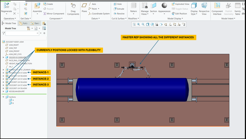

I am working on a large assembly file which contains a sub assembly that is modelled with flexible dimensions. The screen shot of the assembly is as shown below:
I have made use, of 2 instances of above assembly as a sub assembly in top level assembly and shown them in different configurations as shown below. This was done by modifying the flexible dimensions shown above:

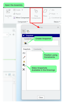

From the description, pictures I presume that the flexibility is only for the angles.
If so, then it is not a Flexible Component Design as defined in Creo. This is just a mechanism. At best it is an underconstrained assembly with a single degree of Freedom.
Create "Snapshots" of the positions.
You can retrive the snapshots at a later date and can also have them in the drawings.

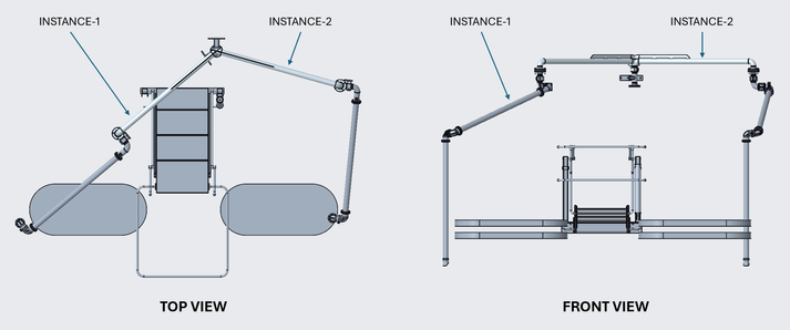

Hi Srinivasan,
You are right, this is just a mechanism, and I am aware of the snapshot technique.
This technique works absolutely fine when I have only 1 instance of the Sub-assembly in the Top assembly.
but what I am looking for is a solution, when I need to place more than 1 instance of the same assembly, like shown below.
The concern is, the position of the sub-assembly goes through different iterations between us and our customer until customer is satisfied.
Therefore, it becomes very difficult to work on the sub-assembly multiple times to alter their position and take snapshots.
Also, while making using of mechanism, altering the position of 1st instance tends to change the position of 2nd instance as both the instances are of same sub-assembly loaded in memory.
This is the main reason; I make use of component flexibility to lock the instances in different positions independently.

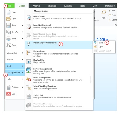

it appears that these are the various iterations before finalizing the design with the customer. I suggest that you use "Design Exploration Extension" where each iteration can be defined and then the final one can be set as the Design.
To start a session, follow the below sequence. Also read up on Design Exploration in the help section.
