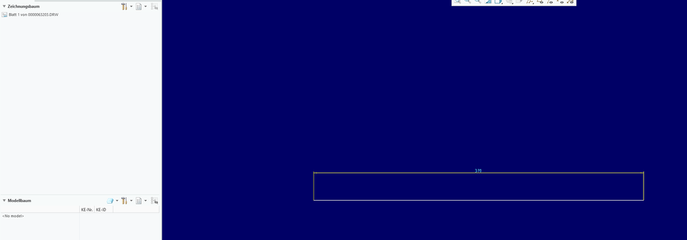

Let's say I want to manipulate (after the final creation) a line like this. Is ther a way to do it with the dimension annotation? It would be like a manipulation in the Sketcher (3D) where you can modify directly the dimension.

No, to the best of my knowledge you can't modify sketched lines in a drawing with dimensions like you can within a 3D model sketch.
I avoid sketching in drawings simply because they are not controllable. Instead I will make a part model that is just a sketch and use that model in my drawing or I add sketch features within an existing model to show added lines in a drawing (for us, these are typically related to manufacturing information that is included on a drawing)
