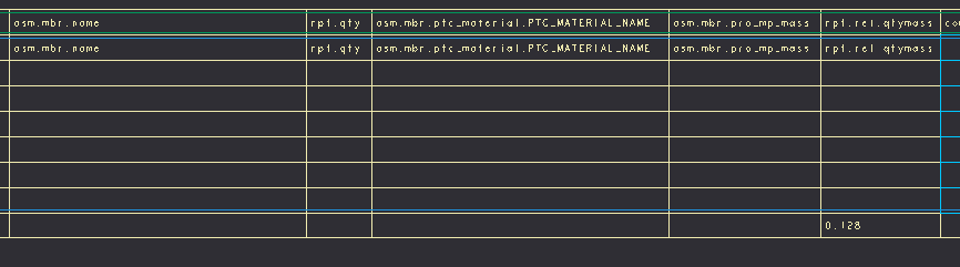

I am attempting to create a repeat region that sums the mass of different material types in an assembly.  The issue is I have different common names using the same material in the table.  I know I can do this through filter, but I am being asked to provide a different solution.  Oh yeah - I don't know how to write relations!

 Include in your table  these columns "rpt.qty" "asm.mbr.pro_mp_mass" "rpt.rel.qtymass"  and {optional "asm.mbr.ptc_material.PTC_MATERIAL_NAME"  }
         (add some blank columns, set switch symbols to see the symbols, double click in second row cells and  build up the names of the columns, switch symbols to see the result)

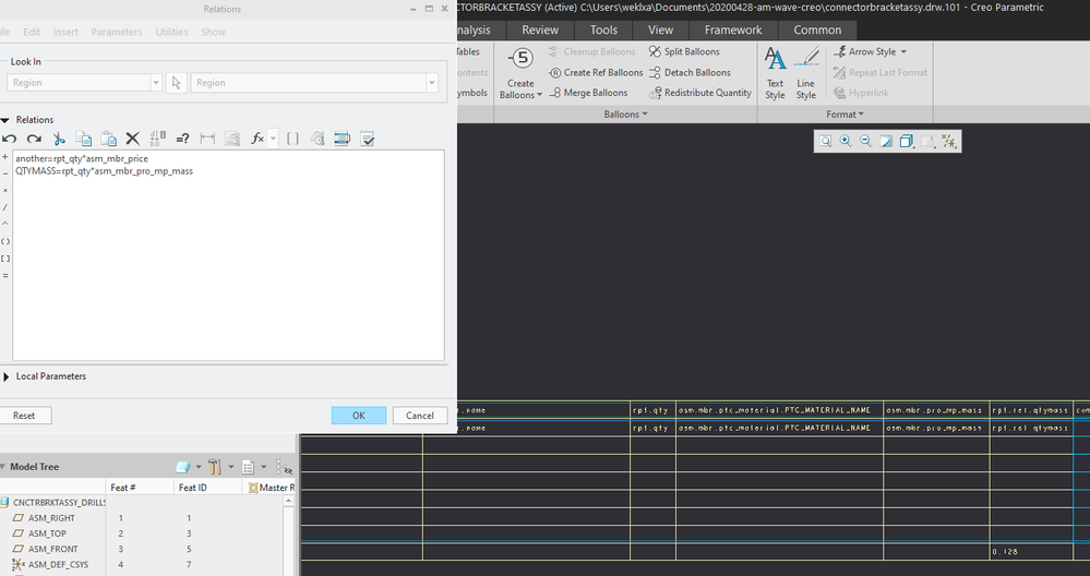

Add a relation              QTYMASS=rpt_qty*asm_mbr_pro_mp_mass
         (Repeat Region->relations->select table-> type the relation (can also right click on the parameters in the list and add to the relation.)
Update table and regen and you should have a column of masses.
Add sum:            Add a row to the table to place sums in, Then:
               Table-> switch symbols (to show symbols)
               TABLE –> REPEAT REGION->SUMMATION select the region
               (TBL Sum) ADD -> ByText –select the parameter to sum(in row 2), "rpt.rel.qtymass" ->enter a name for it "sumqtymass" ->pick a cell to put it in (note it does not necessarily have to be the cell below the column being summed, but that is where I would put it)

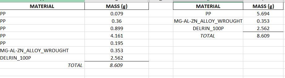

I would like all the PP (or like materials) to consolidate in the same row along with the mass.  So, as you saw in the one table where PP material is a quantity of 5, there would be another column for mass and all 5 of the masses would be summed on the same line.

As is in Excel:
Hi Helena,
Each row is a part or an assembly. try making a subassembly for your parts made out of pp and moving all your pp parts into it. then you can show the assembly on a line. (Is this to know how much plastic to buy?)

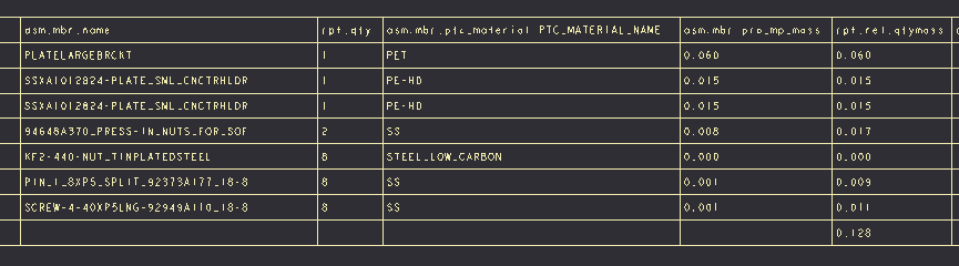

fyi-attached is the part of the table I was working on, and its relations.20200708-table snip.PNG20200708-table snip switchsymbols.PNG20200708-table snip relations.PNG
