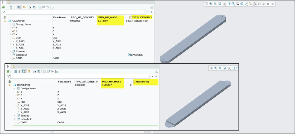

Chris3
(To:BillRyan)
I tested with and without the config in 12.4.0.0 and there is no change. When a feature is removed in a rep, the mass properties still reports the master rep mass.
Someone can correct me if I am wrong, but I don't think working with bodies helps this issue. The part rep definition in Creo 12.4.0.0 hasn't changed and there is no option to create a rep using bodies (boolean features are hidden when you go into part rep definition).
It is wild that the mass doesn't change when geometry shown on the screen changes. 😞
