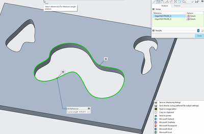

Coming from Solidworks to CREO I am hoping the following is possible, I cannot seem to find in the measure tool a means to measure perimter area. Screen shot example of what I'm trying to calculate:
It is not possible to select area on perimteter, is this possible in CREO?

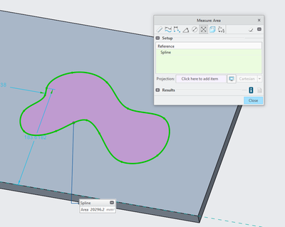

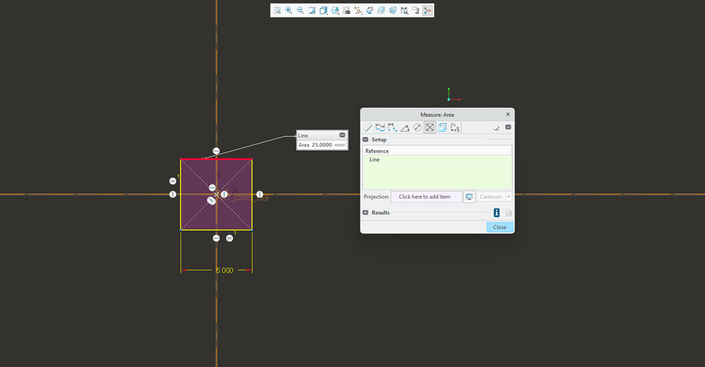

In some cases, you can measure the area within a closed curve in sketch mode as shown here. Use the measure tool inside the sketch.
If you need to so this external to the sketch, then as @MartinHanak has suggested you can create a planar surface using the fill function (inside your curve) and measure the area of the fill surface.

I think you cannot measure an area of empty space. If it is planar curve then you have to create Fill surface and measure its area.

Thanks for the reply, I was hopeful this could be done via the measurement tool. Good to know I could use the Fill option.

Thanks, although it would be nice to have this in the model enviroment, it's not a problem to access via the sketch:
