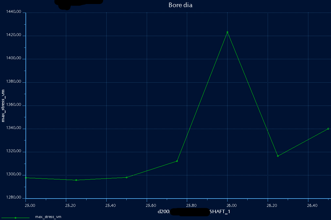

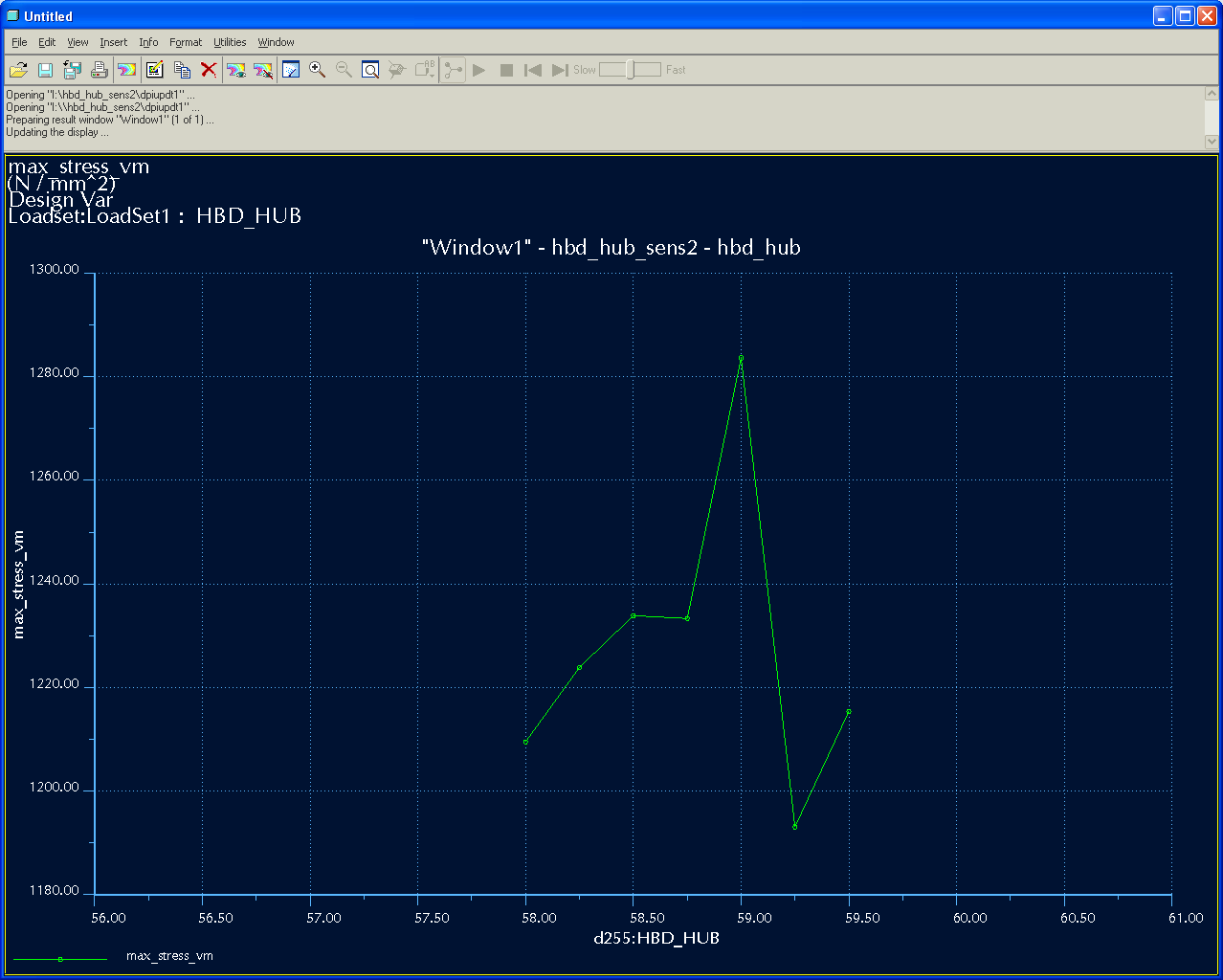

I've just run a Mechanica sensitivity study (linear static, using Single Pass Adaptive, remesh and repeat P-loop each iteration) and got the following result:
(If this isn't legible, the lower end of the curve shows just under 1300 MPa at a dimension value of 25, increasing to 1340 at 26.5 but with a spike of 1420 at 26.0.)
I've used mesh controls to apply a pretty fine mesh, and geometrically there's no reason for any odd results at that particular point (I'm varying the bore of a shaft with OD 42, and max stress is on a chamfered radial Ø3 hole through this portion of the shaft).
More strangely, I then set the dimension to 26 and ran a single static analysis - and found a max_stress_vm of 1321 MPa, which fits the curve pretty much perfectly and disagrees with that high data point.
This spike is a variation of 7-9% on the 'basic' stress which seems like a very large error margin - what gives? I've tried Multi Pass Adaptive in the past, but I've found that without mesh controls it doesn't necessarily converge well, so I generally just use SPA and use my judgement to add mesh controls where needed. As you can see, six of my seven data points do follow a smooth curve using this technique.

In your first example, did you try to make a sensitivity study from 25.75 to 26.25 with 3 steps in order to see if the same problem occurs at 26?
Thanks Sylvain - that's a good suggestion.
I've just run a test, and the sensitivity does return a consistent result for a given dimension value - so yes, the value at 26 would be the same regardless of the step size.

In the first message, you said "More strangely, I then set the dimension to 26 and ran a single static analysis - and found a max_stress_vm of 1321 MPa, which fits the curve pretty much perfectly and disagrees with that high data point."
Could you try a single static analysis with the dimension sets to 25.75 in order to check the accuracy of this step of the sensitivity analysis?
Your colleague's theory could be true, but it doesn't explain the peak in the result's curve.

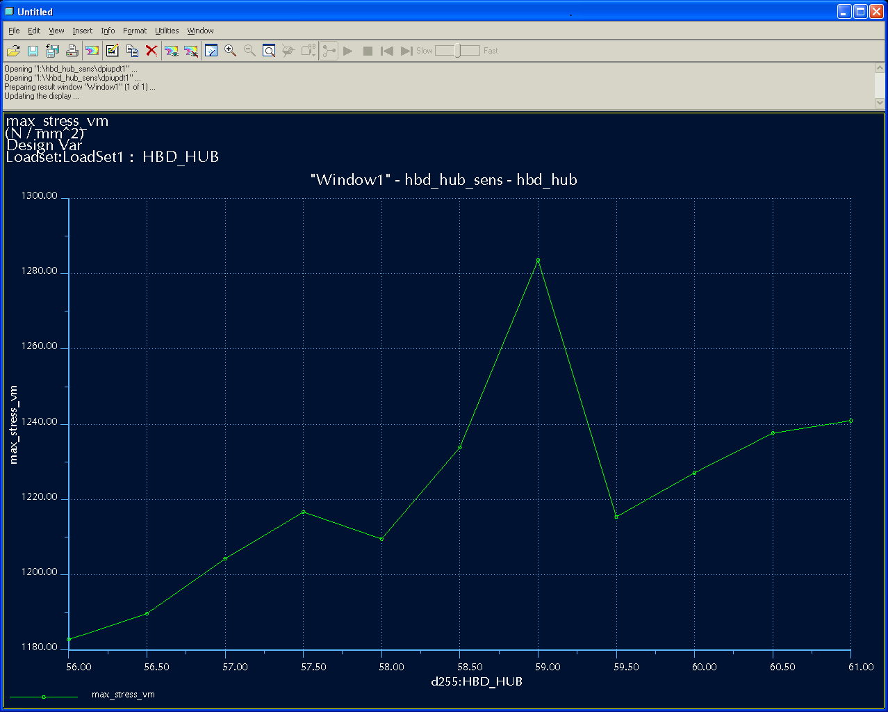

I don't have the original model any more, but here are some results from the latest one that I've 'frozen' so that I can continue to investigate this:
Single-run SPA results are as follows (fortunately, the run time for this model is around 7 seconds!):
58.00 1200 MPa
58.25 1221
58.50 1190
58.75 1209
59.00 1204 (confirmed by re-running)
59.25 1244
59.50 1214
So you can see that:
  • both sets of values are slightly erratic, as you should expect from FEA
  • the overall range (1190-1244 vs ~1192-1235) is about the same if you ignore the single point at 59
  • every value is different to the Sensitivity Study results.
So perhaps there is really a convergence problem with the Sensitivity Study, especially as MPA apparently does not produce the high value - if the convergence criteria is somehow different then that could explain it.

I have seen results like this when I make sensitivity plots of global measures such as "max_stress_vm". In such cases, the maximum von Mises stress, might occur at one location in the model, for a certain parameter setting, but in an entirely different location in the model for a different parameter setting. The measure vs.parameter plot then may appear discontinuous. In such a case, if you create local "at point-" or "near point-" or "over selected geometry-" measures this problem goes away. But I obviously can't verify if this is the case for your model.
Thanks Mats.
I do use "over selected geometry" measures most of the time these days.  However, this doesn't address the basic issue that running the same model gives different answers depending on whether it's standalone or within a study.
My most recent update about meshing is also weird - as I said before, it's just maths, and if you ask a computer to do the same maths (however complicated) twice, it should give you the same answer twice.  This applies just as much to the meshing as to the stress results!
Oh, I didn't realise you got different results in design study vs regular analysis, I thought it was the discontinuity that was the issue. Need to read more carefully... Strange though, as you point out, it should give roughly the same result. A small discrepancy would be understandable if mesh settings are slightly different when running design studies vs standalone, but not a significant one.
