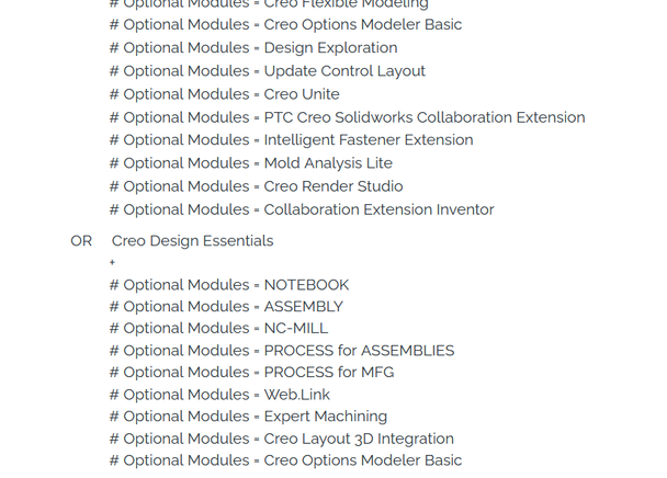

Last question. Here are the different modules between creo "Essentials" and "Advance".
https://www.ptc.com/en/support/article/CS298294
2024-09-26 15_51_49-Article - CS298294 - List of modules in Creo Design Packages_ Design Essentials,.png
Whitch module enable the Inheritance functions ? "Assembly", "Process for assemblies", other ?
Is it possible to buy only this module separately ?
Thanks in advance.
You can buy Creo Advanced Assembly Extension separately (not part of a package) if you wish.
