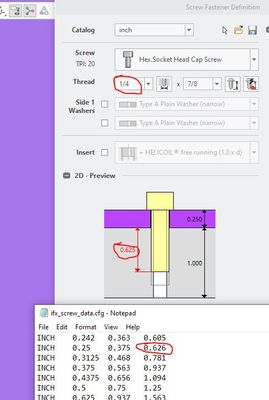

Hello - I updated my ifx_screw_data.cfg file for the "MIN and MAX Screw-in depth for screws".  In my example, I set the max depth for a 1/4 diameter screw to be .626 inches.  But, when I select a screw that creates a .625 inch depth, it is still showing red in the preview.  I thought that changing theses values in the ifx_screw_data.cfg file would cause the preview to show green between the new min and max range that I set.  I closed out of Creo and re-started but my changes still don't seem to have taken affect.  What am I missing?

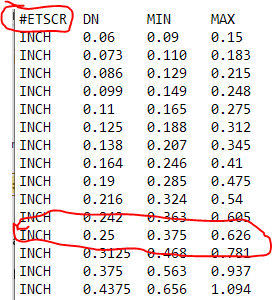

there are two sections in 'ifx_screw_data.cfg'
  • #ETSCR - used for screw-in connections with thread
  • #MUSCR - used for connections with nut
Please make sure to make your changes in the correct section.

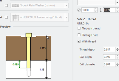

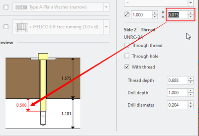

I have tested this here on my end with #ETSCR - MAX = 0.5 and it works proper.
GREEN for 0.499
RED for 0.500
Maybe you make your changes in the wrong file.

Hello Oli,
I double checked and I did change the #ETSCR parameter.  I also do not have IFX_USER_CONFIG_PATH set on my computer.  I tried assembling the same bolt again today and I still have the problem.  Below is my ifx_screw_data.cfg file:
