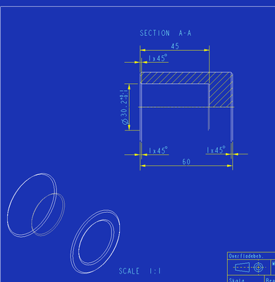

Hi
I'm missing lines on my 2d drawing. Is it possible to "update" all views
KenFarley
(To:OR_22)
Seems like you've somehow turned off silhouette edges.
File->Options->Appearance->Entity Display->Show silhouette edges
Or at least that's the only way I found to duplicate what you show in the isometric view.
Unfortunately, changing this doesn't seem to affect existing views, meaning I had to redefine the view to get it to "update".

StephenW
(To:OR_22)
in your cofing settings, turn on the option;
display_silhouette_edges YES

Hi
I found a solution to my problem.
This problem occurred after updating to Creo 10 from Creo 8. It seems we have some older drawings with an unusual setup.
What I did
  1. Chose the view with the missing lines.
  2. Properties
  3. Under View display “display style” was set to Default. I changed this to “No Hidden” and all was ok.
  4. Save
