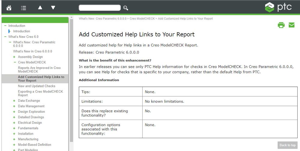

@lwestbrook Could the Creo 6 help documentation be improved for the new ModelCheck Customized Help Links in Creo 6? It mentions it as an improvement but there's no video or image about how it functions and I can't seem to find any help documentation about to create customized help on a check.

@lhoogeveen Thank you for catching that! I'll look into it. Not sure when Help will get updated, but I'll post instructions here asap.
Any luck with getting the Help Documentation updated?

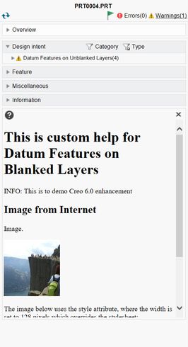

Here it is.
Custom Help files needs to be in checks folder, Set MC_CUSTOM_HELP_PATH to checks folder.
html file names needs to be check names om html format.
I hope this will help.
Is it possible to add images to this customized help?
@Victor_Lopez
It is possible, it all depends on how you create webpage... I am not an expert in webpage design but with the help of google.... created one.
