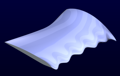

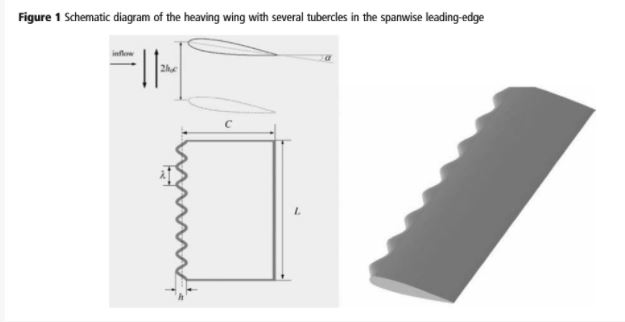

Hi all,
can anyone please help me how to draw tubercles as shown in the figure on an aerofoil blade attached here
blade.zip consists the iges file of the blade for which i want to add tubercles
20 REPLIES 20

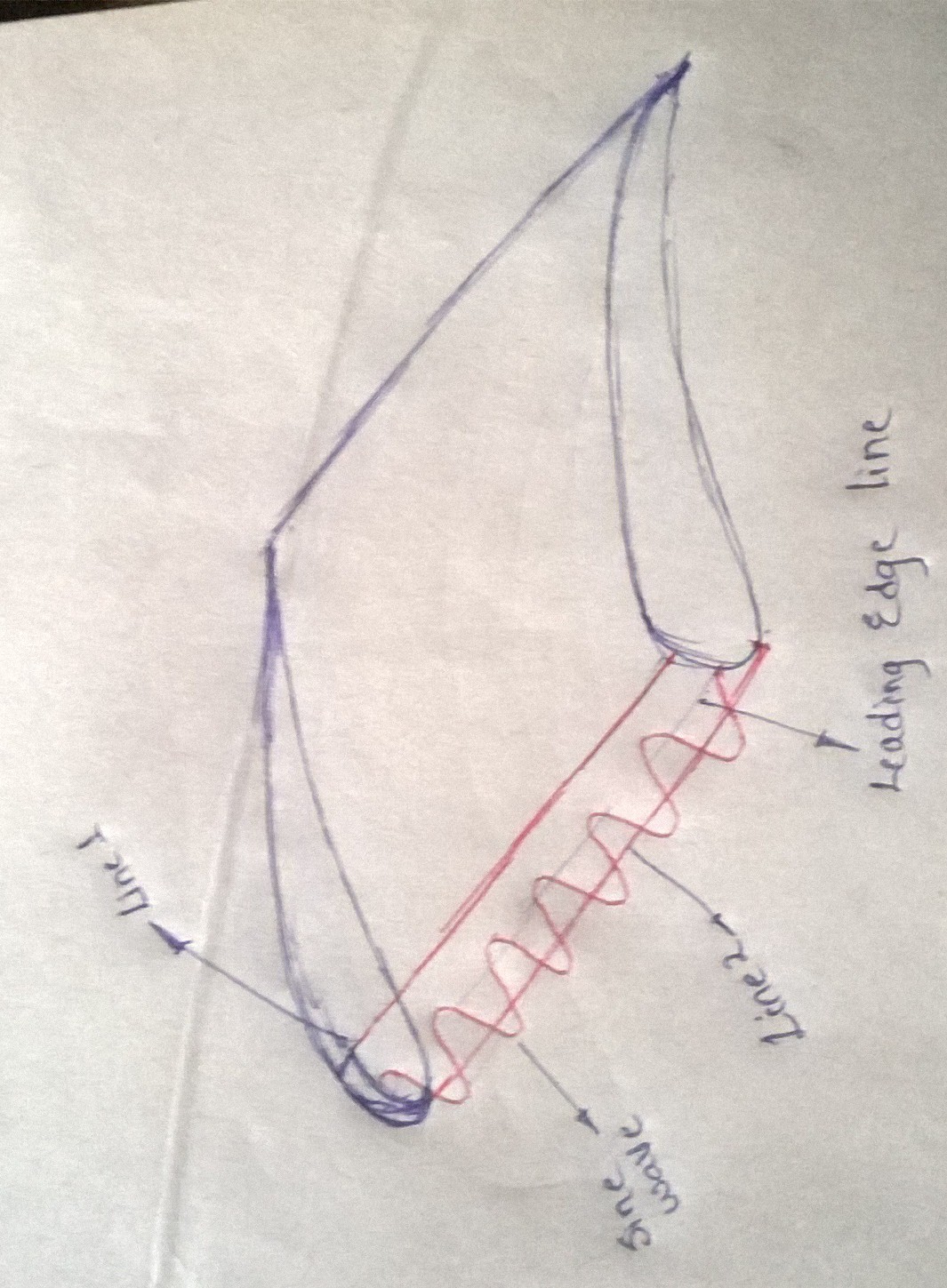

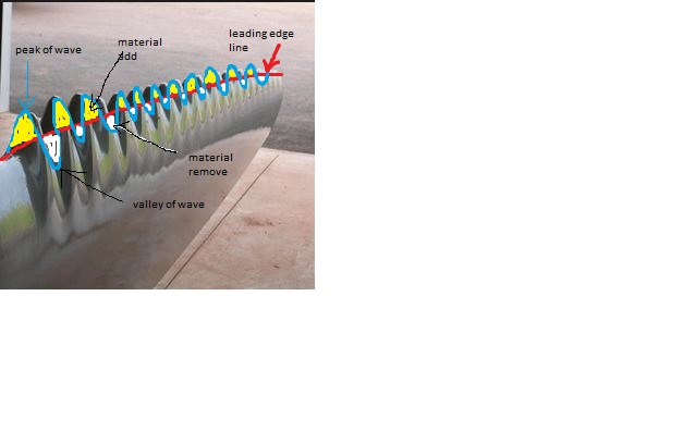

Hi TomD,
The image which I have attached is from google, so I don't have any data regarding it.
I'm attaching few more images and hand sketches.
Naveen

Fair enough; have a look at the attached.
Hi TomD,
I want to have something like that but it is irregular in the model you attached. Moreover, it is also changing the basic shape of the blade.
can we make it as a curve driven??? And without affecting the basic shape???
Naveen
Boundary Blend, Sweep, Sweep Blend, pick your poison.  Get your curves set up.  Figure out how you are going to manage tangencies, or worse, continuous surfaces.  NOT a simple undertaking.

Hi TomD,
I have already attached the model in the first post of my thread and waves can be of sine eqn and amplitude or wavelength  or no. of turns can be of any number
Fair enough, now the model you provided needs a flat leading edge per the examples and other posts.
Please determine and trim your model to show where the wing stops and the tubercles begin.
It may be difficult to maintain tangencies depending on the method used.
Although I agree, this is a challenge in any such air foil.

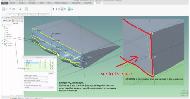

I thought it sounded familiar 🙂
Hi dschenken,
I have seen that post but it is having a vertical surface and mine is NACA aerofoil, and the blade in that post is having a single profile with extrude option but in my case I have different sections with different pitch angles, so I have even attached the iges file of the model.
Naveen
The vertical surface is from the truncated portion of a standard airfoil. Forward of that location is being replaced with the new geometry. It takes little imagination to see that creating the entire airfoil by using more guide curves would allow you to do whatever is required.
