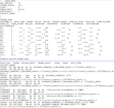

I think the best way is to use custom hole table.
Any text that you see with the hole feature is defined in a .hol file.
The contents of a .hol file looks like this, and you can open .hol file in any txt editor.
So, if you find the .hol file you are using and change ISO to Tap THRU, then restart Creo, you will see Tap THRU appear in your hole table instead of ISO.
If you do not always want Tap THRU, but other text depend on your design, you can create multiple .hol files, and choose to create holes from those file.

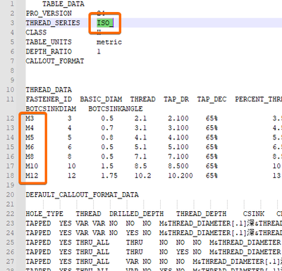

The default ϕ column is from .hol table, but it is not the hole note.
In the image above, the text M4 ISO_ is from ID and Series in .hol file
Although in the hole table, your note will not show, you can add parameters to show hole depth, boring diameter, thread depth, boring depth, etc.
You can control how the parameters appear in the table by editing "Name" column in the Hole Table window shown above.
