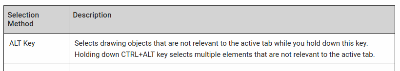

Hello Luca,
for selecting objects that are not relevant to the active tab press and hold the ALT key.
See help page:
https://support.ptc.com/help/creo/creo_pma/r9.0/usascii/index.html#page/detail/Selecting_Objects_in_Drawings.html#
