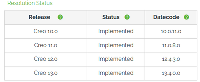

I opened a case with PTC, since we will soon transition to 10.0 of higher soon, and support was able to recreate the issue.  It is being worked on, and I will be updated with any progress.
kdirth
(To:kdirth)
An SPR has been submitted and Article CS455133  published to track progress.
