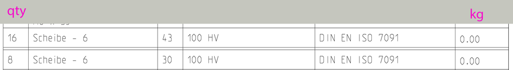

in my BOM I can see that a specific part appears twice, so it has to entries in the BOM.
I used it in total 24 times in my assembly.
One entry has 16 parts (qty), the other one 8.
It is for sure excatly the same part (.prt), still I am not able to combine it.

Here is a picture of the entries:

Here is a picture of the two entries:
I do use relations as far as I know. Sorry that I am not sure because I am using a preset template. But I know for sure that I don't have to fill out for example the weight manually. It automatically reads out the weight of the part and fills it inside of the table.

usually this problem is caused by different weight of these components in case that they are intersected by assembly feature.

But how should they have a different weight? It is the same part. The mass is 0.000988 kg, so round about 1 gramm.
Or are you talking about the total weight (so pieces x mass per piece)?
Here is a picture of the two rows. Note that the BOM lists the weight in kg, so this leads to a weight of round about 0 kg.

Ok I found the reason why it does not combine the two rows.
It is because those 16 pieces are directly in the assembly, the other 8 pieces of the same part are in a subassembly of a subassembly of the assembly.
ASSEMBLY (drawing)
   - 16 pieces of the probem part
   - SUBASSEMBLY
      - SUBASSEMBLY
           - 8 pieces of the problem part

Good to know the reason why something is happening.
I do not know of any way to combine entries in the BOM across sub-assemblies. The system either reports at a single level or all levels individually. Not sure if combining them could be done with a relation, but that might get tricky.
If the software won't let you move the disk components from the sub-assembly to the top assembly, your only choice is to remove them from the sub and add them back in at the assembly level.

Fixed it in the end by deleting them and building them in again.
