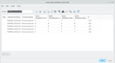

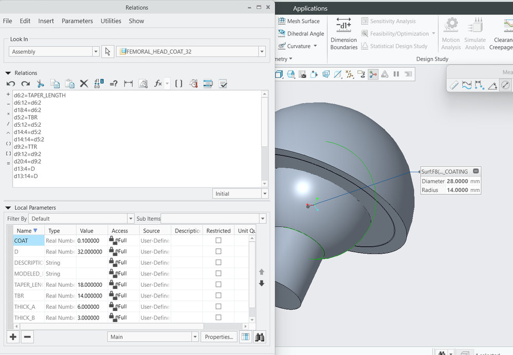

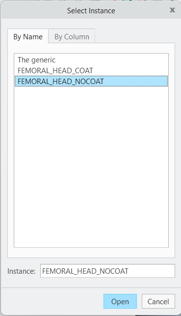

Hi everyone, I am using Creo 9.0, and when trying to open one of the variations of my project created through nested families, the parameter I want to change gets changed but there is no way to regen the model. When I go through the first set of families it works perfectly, then I can choose the generic and everything works fine, but it doesn't work as it should.
I attach some photos.

You're using Session IDs in your relations. Every instance in memory will have a unique Session ID. If you have used d6:2, but the instance now in use is different, i.e. it now has Session ID 28, your relations will not work as expected.
When I need to do something of this nature, if I do in fact understand your intent, I ensure the component models have all the different iterations needed, then call those in the assembly family table.

I don't see how that would be my issue, since my relations are working perfectly fine, except when I try to change the parameters from the family table it just doesn't work. If I get to just the coat or no coat versions, and then I select the generic version of those, it lets me change the parameter and regen it properly, but not if I do it from the family table. I've tried to put it all in the same family table, as I understood I should do from both comments I've received, and still it doesn't work. I did it with nested families in that way since is the way I've learned at university.
