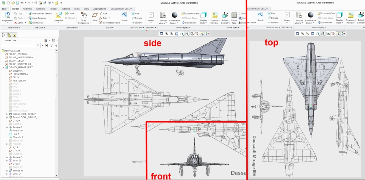

Hi Pravin,
Trace sketch-draw contures in horizontal,front, top planes. Also add few contures on certain crossections and then use boundary blend till you close outer shape of car. Then trim if needed and later merge those surfaces so you can solidify shape or use thicken instead.
Google for veyron schematic pics to use for trace sketch.
Here is sample of similar work done using trace sketch.
Hi Davor,
Is there a tutorial that i could see on making the blends when the tracing on, im fine with everything else you said its just that i dont know how draw the lines on the sketch once i have added the front, side and top images, including after i have done the sketching on the plane how do i go about using the bound blend.
appreciate help thanks
