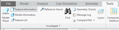

So I noticed that when I create an offset datum plane its being hidden automatically. So I tried to put it in layer, which is visible, planes are visible but no results. Also I searched for some kind of option, but I could not find it. Is it possible to change, so it can be visible? I am using Creo 6.

A couple of things to look at:
Is the datum display for planes turned off?
Are all of the layers that the datum plane is on shown?
Use Feature Information to determine which layers the datum plane is on.

Thank you. This function Feature Info. helped me a lot. 🙂
