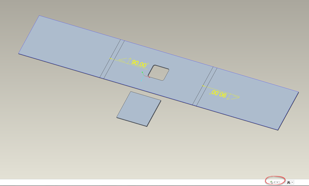

You have one continuous piece as shown in the picture of your model. There is only one piece. Here is a picture of a model with two pieces and how the icon indicates this. This is in sheetmetal mode in Creo 7.

In sheet metal mode it means there are not two (or more) distinct solid geometries that are not connected.
Refer to this section of the help files (typically incomplete treatment of the topic):
Working with Two or More Distinct Pieces (ptc.com)

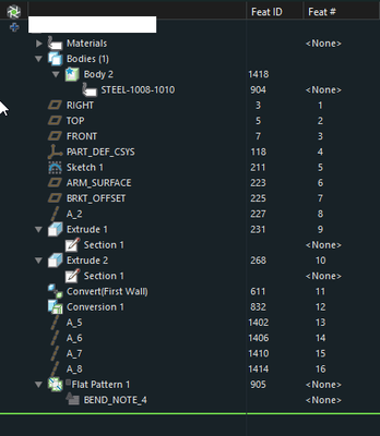

Could you explain exactly what entails "two (or more) distinct solid geometries that are not connected"?  The model tree below has extrude 1 and 2 which are a connected body and we are still receiving the error.  I would think this is distinct geometry.

You are still not providing enough information to troubleshoot this efficiently. What version of Creo are you using? Post the model here for review.

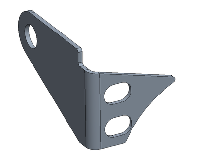

ewhitaker
(To:tbraxton)
Here is what the part looks like.  CREO 7.0.6.0
tbraxton
(To:ewhitaker)

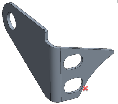

tbraxton
(To:ewhitaker)
This is unrelated to your query, but I see a potential issue with the design of your part. The hole is too close to the edge at this location. It will be difficult to make with a shearing process. I would check with your fabricator about this.
