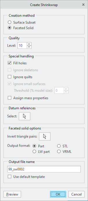

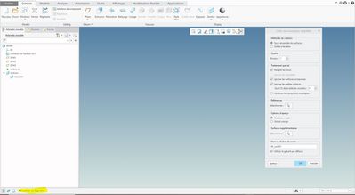

I open the obj file, and export it to a shrinkwrap. and when it calculate, no surfaces is create.
I don't know why sometime it work, and sometime doesn't.

I did successfull conversion in Creo 5.0.5.0.
Martin Hanák
thank you martin,  just need to uncheck ignore quilts 👍
