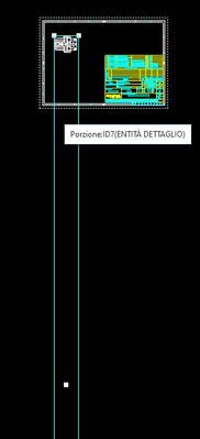

Hi, how can I resize the view window based on solid model?
I'm using CREP PARAMETRIC 9.

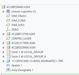

I have the necessity of draw a surface "Area designata 1" in an assembly, then I have to hide the surface in drawing.
Althought I hide the surface, the view window is oversized because it feels the presence of the surface. The oversize of view window causes problem of views overlapping.
How can I resolve this problem?

A different way to do this is instead making the surface feature "Area designata 1" in the top level, make the part that contains the surface feature, then use simplified reps to turn off the part.

I usually make these sorts of views a Partial view (in the view properties) and sketch the boundary so it controls how large the view is. Not automatic by any means but effective.

I won't tu apply a partial view, because the assembly is too large and I want to apply an interrupted view too.
