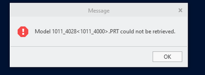

Renamed an instance name, then opened the drawing:
I am almost certain that they are from Pro/E. That was the software used by our company when these files originated. As I said these files are nearly 30 years old, so I'm guessing they would not be guaranteed. The file does not open at all. No blank views or anything.
Here is the actual error message. I tried to create a dummy model and save it in the same folder as the drawing and I still received an error message.

Did you try first ,prt  then .asm?
Dale_Rosema
(To:Dale_Rosema)
If it is an .asm, the error may then change to parts "within" that .asm.
I have tried both.

In the header, it says this:
ANVIL1K   E:\97-3051.SOL\DRAWINGS\3051-1.DRW
ANVIL1K   1222027-SOL\MECHDWGS\4027-1.DRW
I am guessing you had MSC Anvil 1000 30 years ago.

from Hi RJ_5352586,
I confirm Ben's status.
I checked the structure of the file you attached using editor Notepad++ and compared it with a drawing that opens properly without associated models assembly.
Found that the header UGC information is missing in 4027-1.DRW file.
End of UGC information is missing  at the end of your file as well.
See attached screenshots.
So this file does not come from Creo or Pro/Engineer.
Checking on the net and found that micrographx designer generates .DRW file as well.
Where did this file comes from exactly?
