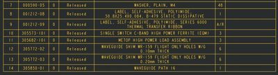

Can you control a table and balloon items which can be fixed the same number every time you do a new assembly drawing? E.G part number 001212-08 will always be item 314 in the table and the balloon item and then show the same with QTY underneath.

You place a part list (repeat region) on to the drawing and it the parts in order of part number 1 to 14

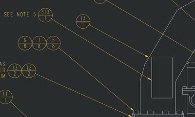

You also added Balloons to the drawing driven by the parts list (repeat region)

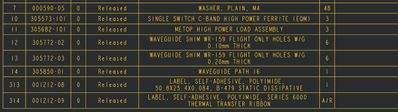

To part number 001212-08 to item 313 and 001212-09 to item 314 you have to fix index to be shown like the below image (Which can be done on it's own but the balloon does not change)
What trying to end up with is the below but when ever you bring in a part list at the start it automatically fixes certain part number to certain item numbers and the balloon changes as well.
What I think I am trying to ask is can fix index before putting a parts list (repeat region) on a drawing?

The problem you will have is that you are using 2 different parameters in your BOM table and in the balloons.
The internal find number is being used in the balloons and a normal repeat region.
You will have to do some repeat region relations to get your stored find numbers into the list for parts that have a findnumber and yet use the internal one if they do not.

Here's how to do this:
1. Go into Repeat Region Relations. Add the following relation:
pos = rpt_index
if exists("asm_mbr_position") == true
pos = asm_mbr_position
endif
This will create a new parameter called "pos", assign it the index value, then, if the part has a parameter called "position", set the "pos" value to that instead.
2. Add a new column to your Repeat Region. This column should hold display the parameter "&rpt.rel.pos". This is in ADDITION to the "index" column. The problem is that for some reason Creo doesn't create the index unless it's displayed in the Repeat Region. So if you remove that column, your relation is going to fail, since it can't find the "rpt_index" parameter. To avoid this, remove the header of that column, set the text size of the entire column to 0.0001, and likewise set the column width to 0.0001. The column should now be pretty much invisible.
3. Select the table (make sure to select the entire table) and Edit Definition/Properties (depending on your version). Set the BOM ballons to display your rpt.rel.pos, instead of rpt.index.
Now you have a repeat region which will use your Position parameter if it exists, and just use a normal index if it doesn't. Note that it doesn't ensure there's no overlap, so if you have enough parts, you could get two parts with the same index this way. There's no simple way to avoid this (there might be a complex way), so I'd recommend to just keep the fixed position numbers high enough that it won't happen.
