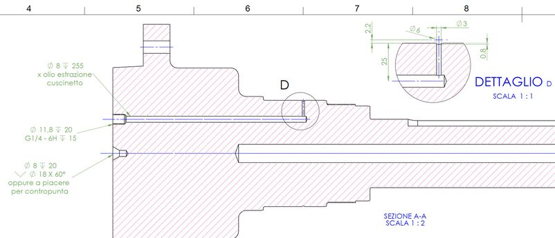

I want to reach the COLOR printing as below:
DIMENSIONS and NOTES: green
Then I use the following in the pentable:
pen 2 thickness .015 cm; color 0.4392 0.6588 0.3607; letter_color
Now, if I want AXES (CTRLFONT L L and CTRLFONT S L) to print in blue, I must assign a blue color (for example) to all the axes manually, and then use the following:
pen 8 thickness .018 cm; color 0.0 0.0 1.0; edge_highlite_color
For the CROSS SECTIONS, to assign RED color manually and then:
pen 4 thickness .018 cm;color 0.949 0.509 0.705; highlite_color

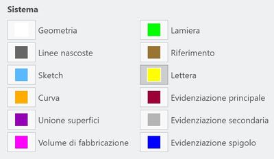

I mean, when specifying the color scheme in the System-Appearance configuration UI, there is this palette:
When it is exported to a .SCL file, the names are:

( 19 named colors...  note they're specified in terms of % of RGB.  Which one corresponds to "Sketch" in the GUI? - through trial and error, I've decoded that it is SYSTEM_SECTION_COLOR)  Anyway, this is a bit of a behind-the-scenes detail but I want to illustrate the inconsistencies.

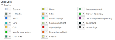

So then, you can assign a color to display on the screen for common elements - but from a reduced palette of 13 "Theme Colors":

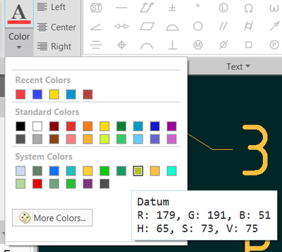

It is curious that when you use the "Format" menu in the ribbon, for example, to assign color to text, it seems you have 16 "system colors" to choose from:

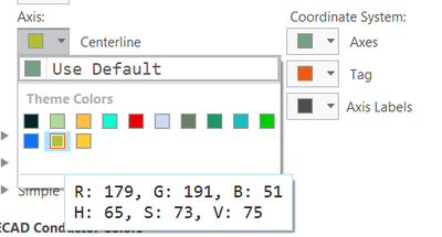

Anyway, if I want axes to print as blue, then I see two ways of doing it.  With reference to my color-scheme above (note use of the "Datum" color for drawing axis center lines - the default is I think is to use the "Letter" color):

2) I make the "Datum" color blue in the UI, and then in the pen table, I can remove the color override:
pen 9 thickness 0.006 in; datum_color;

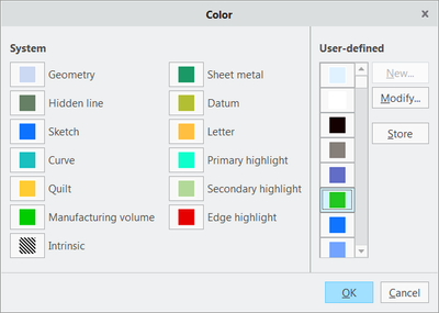

Then in my models / drawings, whatever I painted as a "user defined" color:
will be printed in that user-defined color.  So for example, the text for your view names that are in blue - you could color such special text a user defined blue color which would be printed using pen 1 (and the "letter" color would be specified as green in the UI or assigned to a green pen in the pen table)
