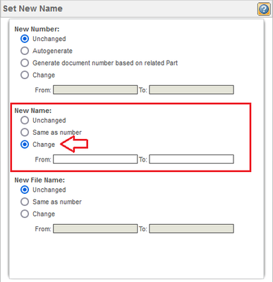

Are you sure you changed 'Name' and not 'File Name' or 'Number'?
There should be no problem with family table instances each having their own unique name (PTC_COMMON_NAME).

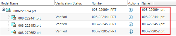

The Windchill side appears to be correct. But in Creo I have PTC_COMMON_NAME as a column on my model tree, and it is wrong there. Our CAD to ERP application uses the PTC_COMMON_NAME that Creo is showing in the model tree. I have tried renames, new workspaces, updating, syncing. We see this issue with multiple un related parts.
Correct in Windchill:
Incorrect in Creo:

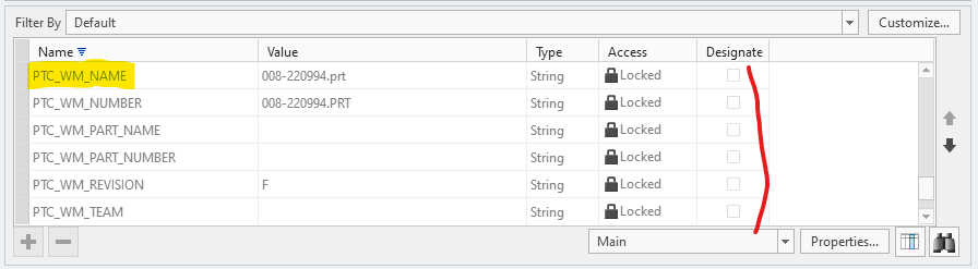

Your system is acting like PTC_COMMON_NAME is undesignated, and therefore not passing values back and forth between Creo and Windchill, but I'm not aware of any way to turn this on and off for system parameters.  Does PTC_WM_NAME show the correct value in the instances?
ME_CADADMIN
(To:TomU)
Instance PTC_WM_NAME is correct.

Then I uploaded Generic and Instance and I tried to open rename window to see the value for Name, and also here (as expected) it was shown right.
