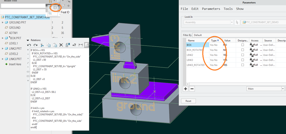

Hi, this remains an interesting unsolved case.

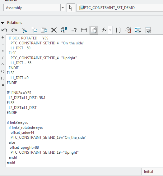

I can't open your Creo5 file so tried to make toy example similar to your new example - using similar structure of assembly level relations & pro/program code to drive constraint sets and existence of components.
Except I didn't use a value of a dimension to determine the logic of whether a component exists or is rotated - I defined Yes/No assembly level parameters:
Toggling these yes/no parameters and regenerating seems to work just fine.  Please try the attached model yourself.
So your code should work, I think, but there is something wrong:
- something in your assembly constraints that gives problems?  unlikely as re-edit-definition fixes the connections without picking new references
- using dimensions (real numbers) to define On/Off states - round-off errors causing the logic to fail?  - again, unlikely because it seems that the correct offset values and constraint set names are being set.
- bug ? - nah, this is PTC software 🙂

pausob
(To:avero)
@avero wrote:
Where does L1_DIST and L2_DIST come from in your model? I can't seem to find parameters with those names on any level?
L1_DIST and L2_DIST are just named dimensions - they control the distances between the level planes.
The main difference between my model and yours seem to be that you have attached the components to a number of level planes (I don't think I could use this method as I might want to place the components on any side of the component named ground) rather than it being constrained to a distance from the assembly coordinate system origin, which made me wonder - If I want Creo to do more than one distance calculation (one for each constraint set) the correct way to do this is
IF CUBE==1&SPHERE==1&PYRAMID==0
D31=500
D26=500
That should work... (see below)
Right? I have also tried
D31=500&D26=500
The above syntax is not correct.
But that gives an error.
I have now also tried using integer, yes/no and string parameters instead of real number, but the same behavior as before occurs in my model.
PARAMETER is real number, as used on the first page of this thread. PARAMETER_1 is integer type, PARAMETER_2 is yes/no and PARAMETER_3 is string type parameter. It doesn't seem to matter (to Creo) which one I use.
So just as you were saying all along, it seems that there is a bug in the software because changing value of dimensions that belong to inactive constraint set does not update the placement (the value changes, but system does not regenerate the component in the new location).
This is very hard to explain well, so I attach the model for your review.
if link3's constraint set "Upright" is active because link3_rotated parameter is set to NO, then changing the above relations to offset_upright = 0 and regenerating will lower link3.
However, if instead you change the above to offset_side = 0, then set the value of parameter link3_rotated to YES, and then regenerate - this will leave the link3 in its old location (44 units above).  Then doing the "edit definition" will snap it back to the new setting of 0.
