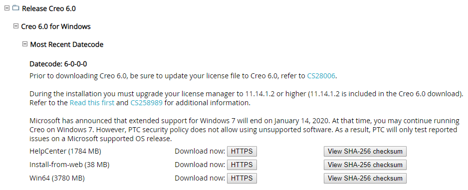

More interesting is the fact they removed Creo Parametric 6.0 from the downloads section.  I got it last week but it's not showing for me now.

The download is still showing up for me:

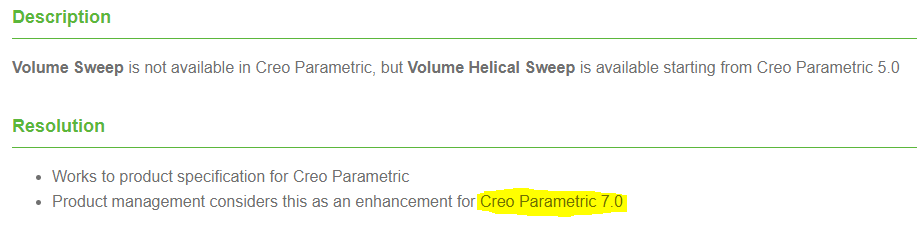

TomU
(To:rohit_rajan)
FYI, it looks like the full blown volume sweep (not just helical) will finally be in Creo Parametric 7.0.
https://www.ptc.com/en/support/article?source=subscription&n=CS313656

TomU
(To:Patriot_1776)
Good thing you didn't hold your breath.  Volume sweep has been tentatively planned for Creo Parametric 8.0
https://www.ptc.com/en/support/article?n=CS313656
