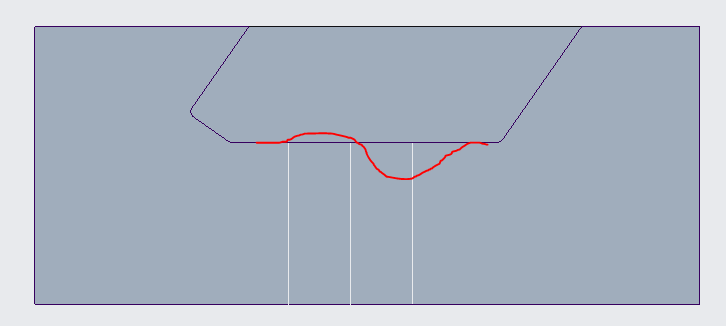

This is a reply to all those who are beyond frustrated that Creo does not have a "solid sweep" function like every OTHER CAD out there does. I share your pain. I can't even ever get the volume helical sweep to do what I want. It never generates when i try to do 4th axis end mill cuts. Very frustrating!

This will get the concaved floor correctly. I asked a PTC vendor for help on this and they recommended hand sketching a spline that matches the angled end mill profile, but no matter how long you spend tweaking it, it would never be perfect. This is mathematically perfect, since creo has generated it via intersections.

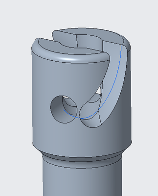

After battling with Creo 6.0 for a while I turned to Google for help and came across this post.. looks like Volume Sweep would be ideal tool to use (see screenshot attached), but perhaps you guys can recommend a workaround?
this will be mbd part, therefore needs to be accurate af 🙄

Can you attach your model?  (Add it to a .zip file first.)  If the profile is what I think it is, I might be able to create the geometry another way...

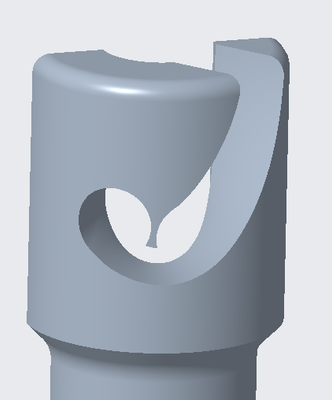

This is the type of geometry it looks like you're trying to create.  If so, it can be done without needing a solid sweep.  Basically just a center surface sweep, an offset of this surface each direction (half the slot width), and the cylinders on each end to cap it off.  This will produce perfectly accurate geometry, as long as the follower stays perpendicular to the center (vertical) axis and the follower's axis always passes through the center axis.

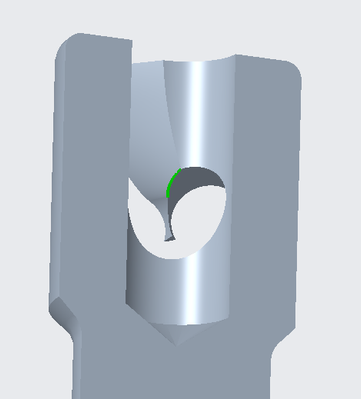

I tried this already, and few other tricks, unfortunately nothing works due to the tight bend, and feature/cut is overlapping itself.
See attached (little clutter in there, but hopefully it will make sense what the intent is..)

to make it easier I removed some of the extra curves and surfaces (see attached)

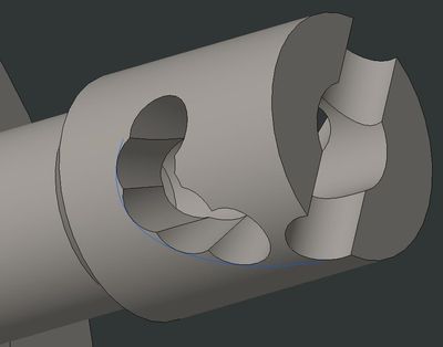

I see what you mean.  The top isn't too bad, but the bottom is not as easy.  3D sweep would make this so simple.  😞

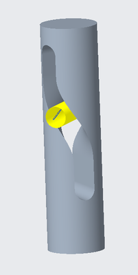

It will be interesting to see if anyone else can figure it out, but I'm stumped.  The sharp edge that's created at the top doesn't play nice with surface offsets:
The bottom side is doable (only showing half):

I didn't keep it.  Sorry.  Everything I was (attempting) to do was based on offsetting the surface generated from the center of the pin (hole) as it rotated down.
