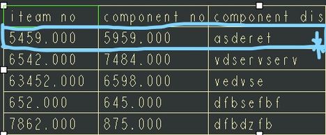

This is the sample BOM that i have created with repeat region and between this 2 rows and between every row in table i want to add blank row , so is this possible in auto generated BOM ?
you have to define repeat region in a two-line table. See attached video.

As you can see in attached image there are components and others things so, I generate the Auto BOM then I export the BOM In excel so there (In that empty line) I want to add temporary materials in excel sheet.
But in current situation I have to add empty line manually, and there are more than  300 lines so its time consuming process.
so.... for this I want to know if there any way that I can add a empty/blank line under every line in auto BOM....?
