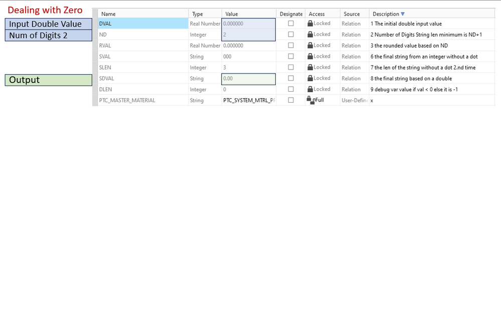

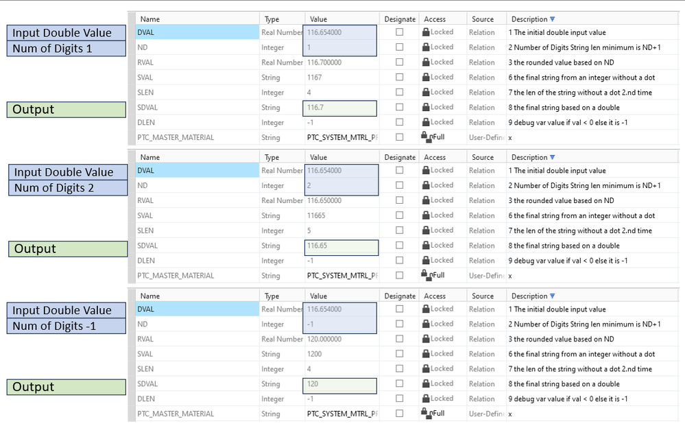

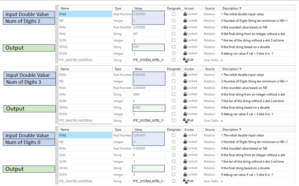

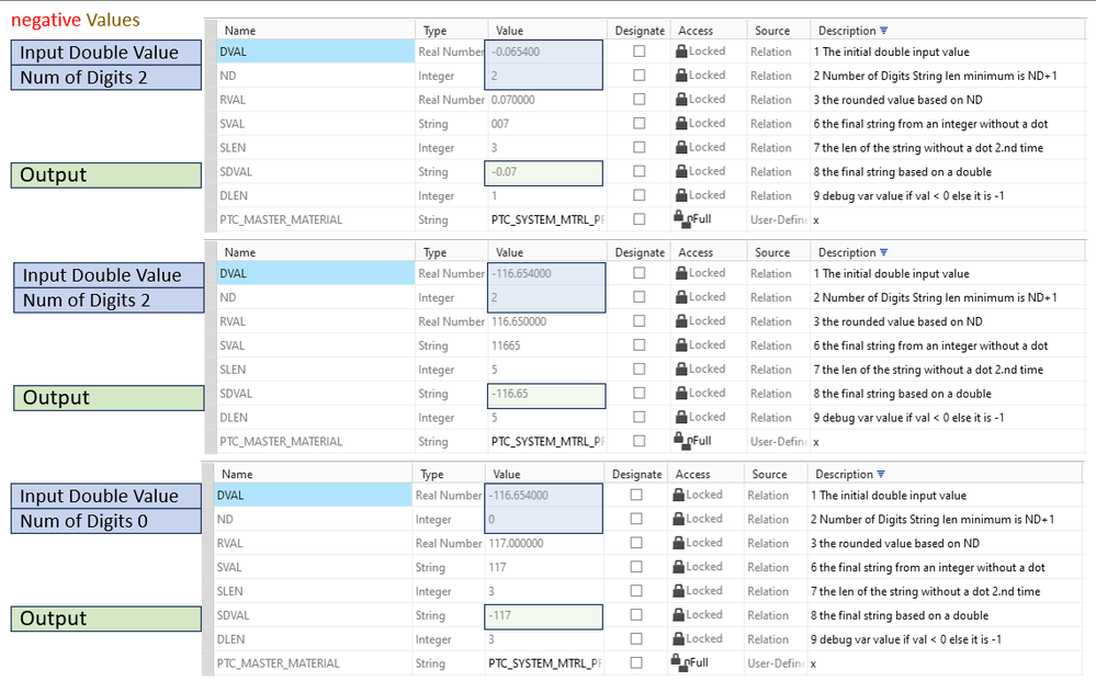

This is working for negative numbers and denominators (-,0,+) as well. Dependent on your needs, it can be simplified.
dval=1.399e-06
nd=7
Output would be -> 0.0000014
dval=-116.654
nd=0
/* Debug Variable
dlen=-1
/* get the postive rounded value
rval=floor(abs(dval)*pow(10,nd)+0.5)/pow(10,nd)
/* multiply by 10 power of the abs value
sval = itos(rval*pow(10,abs(nd)))
/* first string len
slen =floor(string_length(sval))
if (dval < 1)
/* only for Debug
dlen=slen
/* Check if we need to prepend set new sval
sval= extract("0000000000",1,abs(nd) +1 -slen ) + sval
/* set new slen
slen =string_length(sval)
endif
/* only if you are okay with a dot at the end and no trailing number
if (nd > 0)
sdval=extract(sval,1,slen-nd) + '.' + extract(sval,slen-abs(nd)+1,nd*nd/nd)
else
sdval=extract(sval,1,slen-abs(nd))
endif
/* Final change for negative numbers
if (dval<0)
sdval='-'+ sdval
endif
