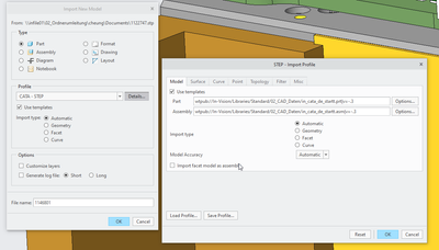

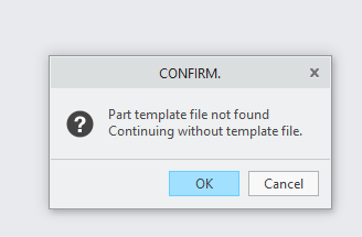

i am having a small issue, when i import a part, i am getting a error message that the part template is not found.
i have not changed any settings nor has anyone in the company changed anything either so im a bit baffled why the import function has decided to lose the default template
anyone know how to check for the template or tell creo to search for it?
using Creo Parametric 6.0.6.0

Hello, thanks for helping.
as you can see i have a profile and a template but despite that being enabled, as soon as i import it, the error message shows

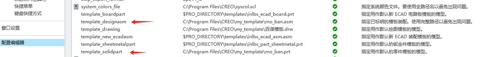

AnthonyC
(To:HF_CHINA)

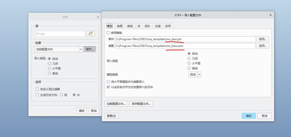

that looks like its part one of the issue, the file that was there was lost and changing it back to prt/.asm worked for the other templates. one template seems to have lost/ been deleted.
could you please help me further and explain / link me to how to create and save templates?

i have worked out the solution. we luckily had back ups of the templates/ prt/asm files.
i just imported it into my workspace and checked it back in to the correct commonspace directory

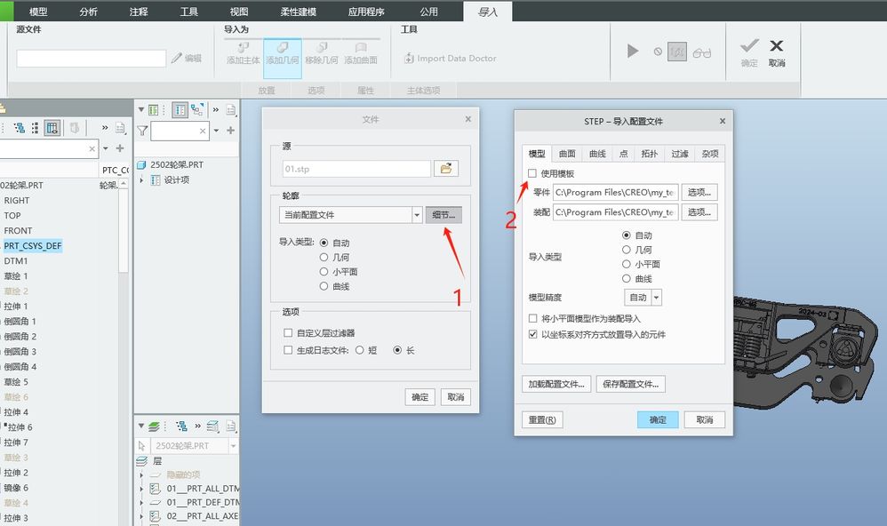

建议放到一个固定且又不常使用的文件夹,以避免不小心删除的风险
