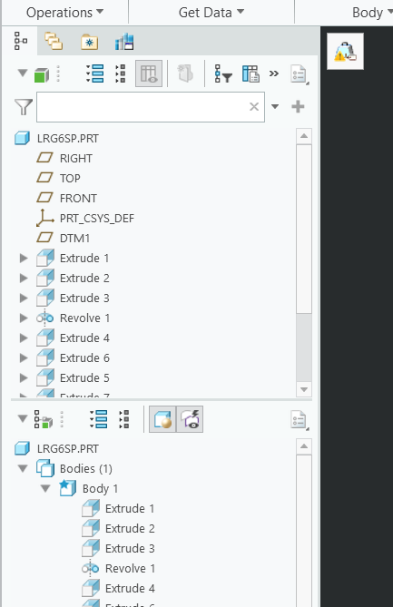

open part in separate window, select item greyed in model tree and apply Show command from minitoolbar.
Martin Hanák
Thank you for the help. Actually all the datum are shown in a part environment. I can hide/unhide with the plane display. but in the assembly, the datum are grayed.
 below is the part model tree. you can see all the plane are shown and have no problem.

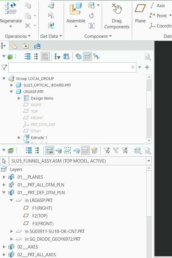

switch to the assembly and show me MartinHanak_0-1687854151722.png datums in model tree.
Martin Hanák
Hi Martin, please see below model tree and layer tree. thanks.

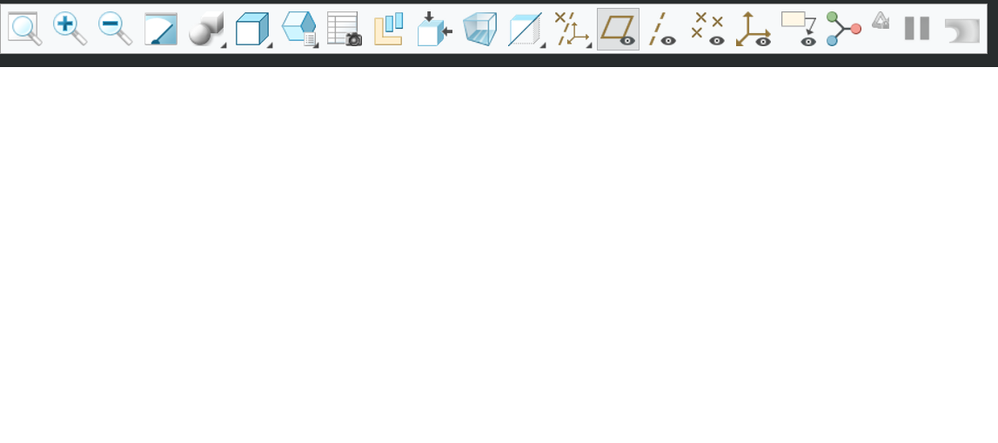

again ... select item greyed in model tree and apply Show command from minitoolbar.
Martin Hanák

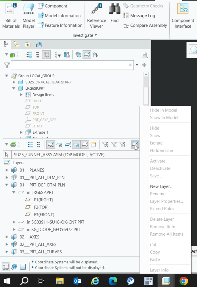

you mean this toolbar? the planes are still grayed.
or below one?
2023_06_27_16_40_22_SU25_FUNNEL_ASSY_Rev_New_Active_wtws_Windchill_su18_su25_funnel_assy.asm_.png

It appears that you have some of the part datums layered off. Select all of the layers and then right click and click "show" from the context menu
AX_4606432
(To:Chris3)
Thanks to all the helps.
please see the attached mp4.
All of the grayed datum cannot be switch on because no "show" tab in the smalltoolbar. And, the problem happens only in the sub-assembly but not in the main-assembly. In the main-assembly, all datum are not grayed and can be "show/hide".
