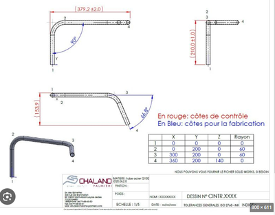

I haven't done a pipe bend drawing in years and don't have the formats/setups that I had at another company.
What is the coordinate system orientation on the drawing. I seem to remember the orientation is like in my screen below shot but I am not sure.

Tubing/pipe bend data drawing for NC type machine.
This was basically what I was looking for. I don't know if the NC machines have specific coordinates orientations but this helped me remember.

I am not really sure what you are asking here, but as you can see, the three views are all in 2D, using the same csys but oriented to each view.
