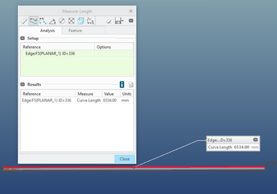

Having been trying to get creo to do a planar bend - it looks like there is an error in either the way I am doing things, or in the way Creo performs the bend:
for example
if the ID = 2080mm, then the circumference should be 6534.5mm.
If I create a flat strip 6534mm long, this should bend to an ID of 2080 with a small gap
so why when the part is bent with a radius of 1040 do i end up with an ID circumference of 6387mm? and a 147mm gap when the bend line is on the end of the part?
why is Creo making the "blank" shorter than modeled.

If you want to bend a strip of metal to a specific inner radius, the length of the unbent piece is *not* the circumference at the inner diameter. You have to calculate it at the mid plane of the strip. In other words, it's a function of the inner radius and thickness:
length = 2 * pi * ( inner radius + thickness / 2 )

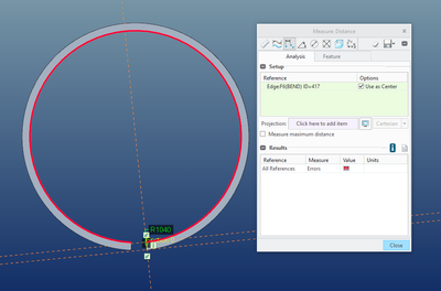

i was thinking that too, but this also does not work.
if i drive the length by:
sd1=floor(PI*(2080+sd0))
sd1=length
sd0=width
then i cannot bend the strip by an internal rad of 1040 as there will be an overlap on the internal corners. the closest i can get is a rad of 1054
the closest i can get to an ID of 2080 is
sd1=floor(PI*(2080+(sd0*0.625))) which makes no sense!

Sheet metal applies a bend allowance calculation when unbending. So depending on your y (or k) factor in your config, it will allow for the stretch of the material when bending. The factor changes based on material and manufacturing methods so it's not a number you can just ask a random stranger for.
That being said, for rolled parts (large radius bends) like you are showing, I usually use the centerlline circumference like Ken showed since the material is only "gently" stretched (LOL, sorry for the highly technical lingo) and generally falls within normal manufacturing tolerances.
Your manufacturing process is the biggest factor in determining the y (or k) factor.

In the real world, large radius bends don't stretch the material like a "small" radius bend does.
I *think* for a big rolled ring like that, you will need a k-factor of .5 which puts the bend line in the middle of the radius. It's been way too many years since I've done this all manually so I've forgotten most everything.
I found this in another conversation about bending  http://www.cutterod.com/cutter_zone/General/bending.pdf (credit Ben Loosli in that post). It discusses manufacturing methods along with some suggested k-factors.
