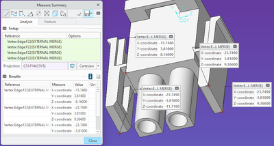

I was wondering if it would be possible to create the forementioned mapkey and what it's config.pro code would look like.
I don't know of a function that can do that for you.

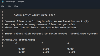

I would suggest measuring all of the points with reference to the coordinate system, save a file, modify the file into a points file and importing.
Select all points and select csys as the projection reference.
Press the info button kdirth_1-1676996515213.png and save information window to disk.
Rename file to *.pts.1.
Edit file to the pts file format.
Select Import button in Datum Point window.

All - Thanks for the quick and helpful responses! Below is a video to help clarify the map key I am hoping to develop if possible.

Your video clarifies what you need. Modifying an existing point within the array is more involved than creating a new point and adding it to the array. I still do not see a simple solution by just recording a mapkey for this. I think you will need to call an external script to create a text file to be read in as input for the point array of the offset csys.
In theory since a mapkey can call external scripts you can edit the text file for the datum point array for the offset csys feature. You would export the results of the measure feature as a text file to use as input to modify the array values of the chosen point within the array. You would need to write a script that manipulates the text files that is called by the mapkey. You can then read in the resultant text file to redefine the points in your offset csys feature.
If you use this often in workflows, I suggest using one of the Creo APIs to implement this.
