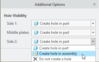

I have a question regarding this. As you could see in the example, if the surface is created in the asm where I put the screw, IFX will create the hole it self in the asm. Is there a method to control this behavior? Let's say I want the hole to be created in the ASM but there is not surface created in the ASM, is there a way to force IFX to put the hole in the ASM?
you can use the IFX option HOLE_VISIBILITY to control this.
HOLE_VISIBILITY
Default is PRT.
SELECT—Select hole visibility.
PRT—Create hole in part.
ASM—Create hole in assembly.
NO—Do not create a hole.
If you use SELECT, then you have to select the position of the hole in the 'Additional Options' dialog.

Thanks, it did work.
