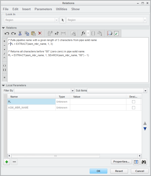

Hello everyone, First of all, I couldn't find a seperate Pro/PIPING-section in the forum on this site, so I thought I'd just post this question here. If there is a seperate Pro/piping-section, please direct me there so that I may ask my question in the proper place. My question is related to Pro/PIPING (obvious by now) and the use of a BOM-table in a drawing. I can't seem to get a 'standard' paramater to go in a BOM-table repeat region alongside a 'piping' paramater in the same BOM-table repeat region. For example: If I put &asm.mbr.OD (for say, an elbow-part) next to &asm.mbr.pipe.segment.stock.OD (for pipe-segments) in the same repeat region, one of them doesn't show. I've already tried several things using relations (among other things), but I still can't get it to work. I was hoping you guys (gals maybe?) could help me come up with a solution (one that preferably does not involve ISOGEN-drawings) Thanks in advance, Maurice

Hello again everyone, I've been tinkering around with my problem a bit more and I discovered that the reason why the 'piping' parameters didn't show up was because (somehow) they are attached to an 'assembly' which contains the pipe extend and the line stock information (and I was filtering out assemblies for some reason 0.o). It turns out each section of pipe consists of one of these 'assemblies' and a corresponding part (which contains the pipe solid). Which leads me to my next problem: there aren't any parameters (none whatsoever) in the pipe-parts (which I want in the BOM-table and not the 'assemblies' because they don't have the right name) for me to call forth in a repeat region. So I guess my real question to you guys is: is there any way to attach line stock information (parameters) to the pipe solid parts so it shows up correctly in the BOM-table? Once again, thanks in advance, Maurice

 Any chance you found a solution for this? It's obvious the pipeline that the solid belongs to isn't completely lost when you create the solid, as it still shows the solid pipes under the correct pipeline when you look at the Pipe Solid Manager. It seems like it should be a simple solution.
Anyway, I came up with one, but it's not the MOST optimal.
When you're creating pipe solids, you let them take their default names, with the pipeline name at the beginning of the solid's name. Then set your repeat region to asm.mbr.name. Then go into your repeat region's relations manager. Add a custom parameter below the relations window (I called mine "PL"). Then just use an EXTRACT() function in your repeat region's relations to pull characters from the pipe-solid's name. If you use the same function for multiple different pipelines, you just have to change the EXTRACT() arguments to adjust for the pipeline name's length (in characters). OR, if you know you'll never get into the thousands of pipe solids per pipeline, and you never use zero's in your pipeline names, you could use SEARCH() to look for the first zero in the pipe solid's name. Get creative with your string functions.
Examples (I commented out the first one as I'm not using that in my model) :
Then you just set your repeat region to rpt.rel.PL
