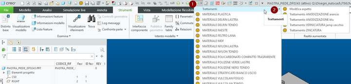

switching from Creo 2.0 to Creo 8.0 and 9.0 I am no longer able to nest two or more drop-down menus in the Quick Access Toolbar.
The example below is visible because I inherited the nested drop-down menu by importing the configuration of the old Creo 2.0.
Does anyone know how to do it?
Thank you.
P.S. i'm using Creo 9.0.0.0

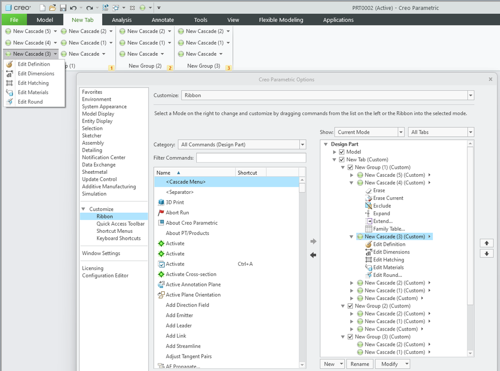

It seems like that ability has been removed.  The best I can do is create a new tab with multiple groups and then add cascade menus to each of those.  Cascade menus inside cascade menus is apparently no longer supported.
