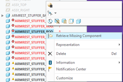

If the components are listed as missing, you can try RMB and select Retrieve Missing Component then locate the files.
Ich habe es gerade versucht, leider öffnet sich die Datei nicht und es bleibt der Fehler

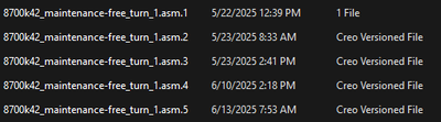

Do you have any older versions of the parts in your directory?  Try opening an older version.
When opening the model, you can select Tools menu and check All Versions to see the older files.

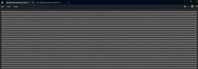

Files appear to be corrupt.
Here is the beginning of the file in notepad for 000_001_002_seitenteil_2.prt.19.

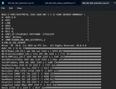

The older version 000_001_002_seitenteil_2.prt.15
You will need to look at the older versions to find one that is good.
soll ich neuere Versionen dann einfach löschen
I would rename until I have a good file saved then delete.
