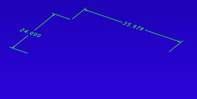

One more issue though... I don't know why but my PVZ no longer shows any geometry!  The annotation is visible and the parts show up in the tree but model space has no geometry.

Check for filters in Creo View.. and turn on the Model Geometry filters..

Excellent!
