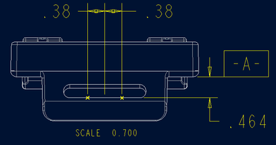

A drawing has a couple of check points: QC_PT1 & QC_PT2.
How can these be shown in one view of a drawing but not in all the other views of the drawing? Is there a way to show points in just one view? Also, you would have to remember to turn these on all the time since typically points on now shown in drawings.
Point turns off
Points turned on, but showing in all views:

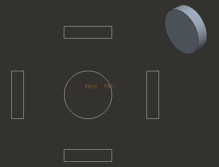

Enclosed is a sample model (Creo 7) and drawing where the points are visible only in one view on the drawing when points are displayed in dwg mode.
Layer tree for the drawing with all layers hidden and the layer tree for the front view (new_view1) with all layers hidden except for layer QC_pts which is shown. See the enclosed video detailing how to implement this.

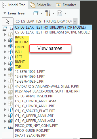

This is the UI element where you can select a drawing view to control the display of layers in that view only and not affect the layers set at the top model (drawing) level.

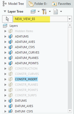

In the layer tab, (2) layers were created: Hide_Qc_Pts & Show_Qc_Pts.
If the show layer is activated, they are there. If the hide layer is activated they are hidden. How do I get them to then show up on the one view?
In the layer tree, I have the view that I want them to show up on active but I am not finding how to activate the "Show_Qc_Pts" layer.

Only one layer i.e "QC_pts" is needed, not two.
Hide this layer in the top model of the drawing. See the UI snapshot below which is the layer tree in drawing mode. Note that both models and view names (yellow) are available for selection in drop down list. When you hide the layer "QC_pts" in the top model then the points are hidden in all views following the layer assignment.
You would then use the layer tree to modify the layers shown for the view in which you want to show the points. Once you select the view name then you can set show status of all layers for this view without affecting the status created in the previous step. By selecting the view, you can independently control the layer status for the selected view.

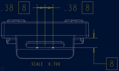

I marked the solution to my question per the video, but I decided not to go down that road.
The points were used to place dimension on the view.
As @StephenW suggested, sketched points were added where the dimension were.
The points were "related to view" so that if the view was moved, the sketched point will follow the view.
Here is my end result:
