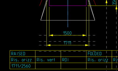

I want to compile a table with automatic calculations. In  the figure attached, I want to plot in the cell the result of a quote divided by a constant number "2560". How can I do this?
Can I recall in the cell the result of a relation obtained dividing the quote with the constant number? If yes, how I could write the relation recalling the quote?

In the model you are showing in the drawing, you could do something like this:
(1) Create a parameter for the value you want to have in the table.
(2) Put a relation in the same model to calculate that parameter's value. You will need to find out the name of the dimension that represents the 1711 value on your drawing. For example, if that is "d1234" and your parameter is "ris_orizz" the relation would be
ris_orizz = d1234 / 2560
(3) In the table on your drawing, you can now put a reference to your calculated parameter so the value will be displayed. You can even limit the number of decimal places that value will show. For example, if I wanted to show the value with three decimal places, I'd put the following in the table cell:
&ris_orizz[.3]
