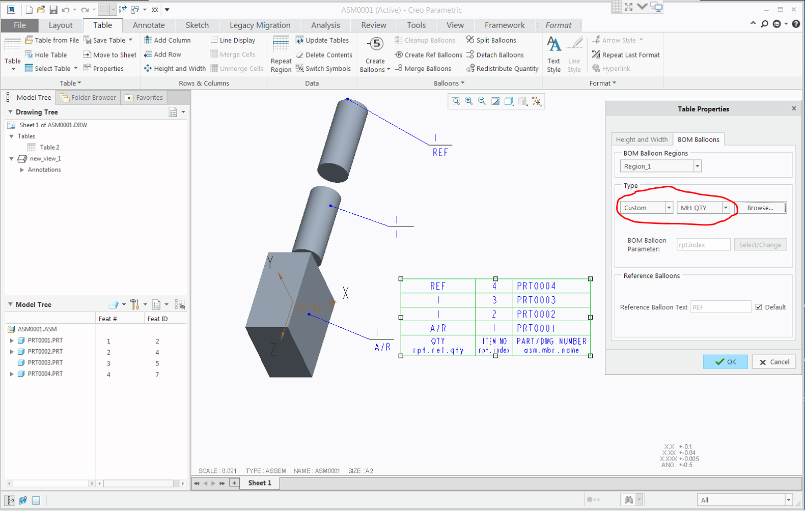

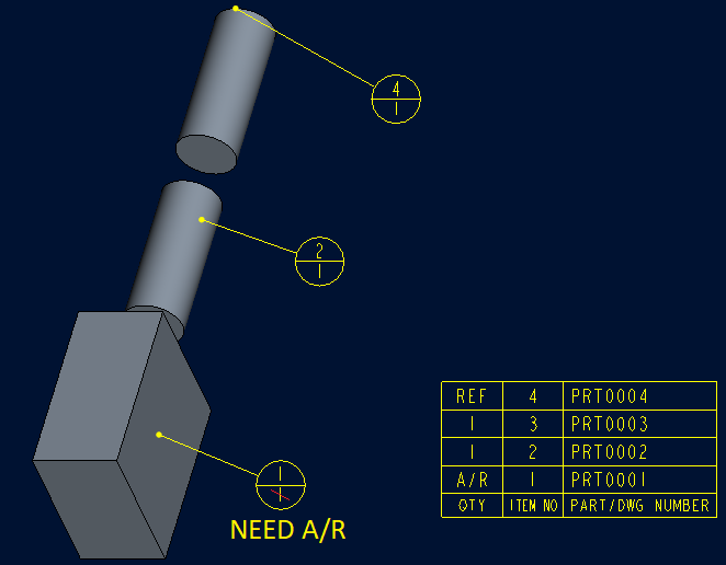

Hi, I use on drawing repeat region with column user defined parameter rel.qty. I need to display my qty parameter in quantity bom ballon.

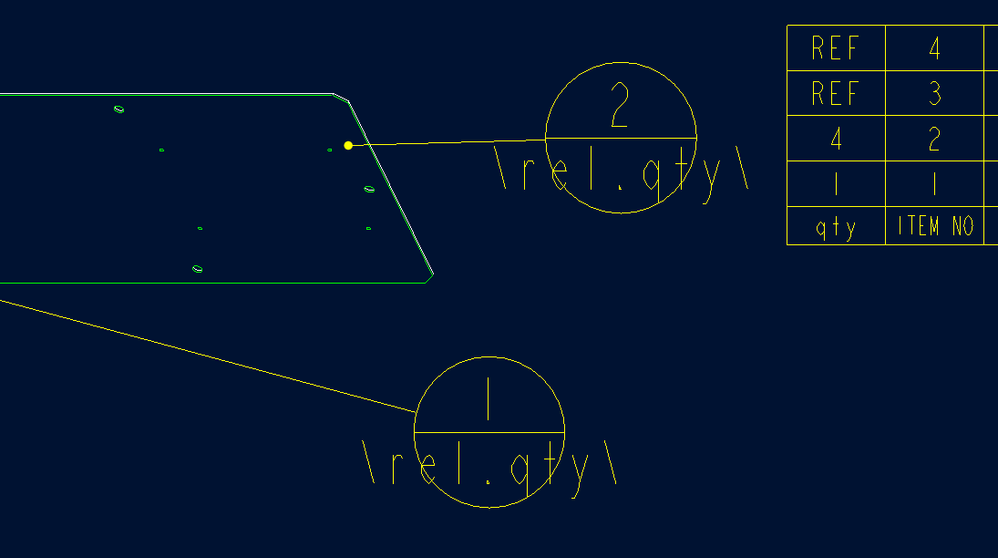

I tryed to modify bom balloon symbol, but it doesnt work. See attached picture.

1.) please upload test data packaged in zip file
2.) if you want to use rel.qty you have to define qty parameter in repeat region relation

I send test data in attachment. I need to have same qty in bom balloon symbol as it is in table.
you have to define BOM Balloon custom symbol. See attached zip file.

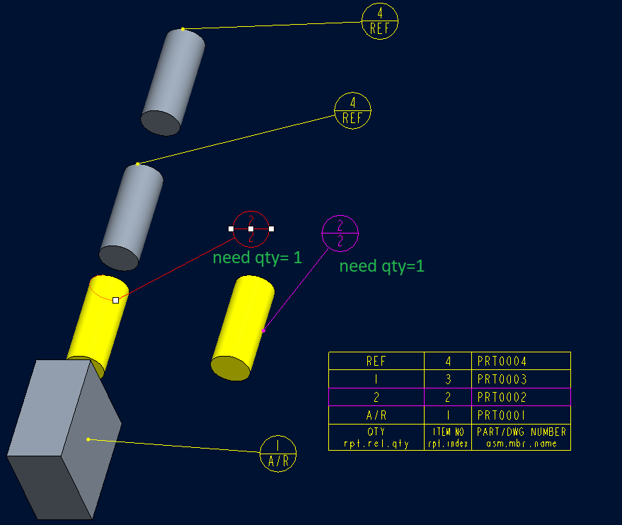

I found problem. If I have in assembly more same parts and each of them has balloon, than qty is wrong.

I think you have bad luck. It seems to me that Split quantity operation is related to rpt.qty parameter, only. You can contact PTC Support to be sure, that my guess is correct,
Martin Hanák
It works very good.
Thank you!
