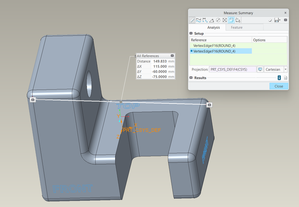

I am using Creo 10.0.7.0 and I was used to taking my measurements without the measure tool on the fly for simple things to enhance productivity and speed. Is there someway I can make this happen in CREO?
An example
I already have a shortcut on the pop up menu but it's easier if I just click an edge or two faces and get an output immediately on the information on the message log.
It already gives me outputs from the measure tool to the message log as shown below.
I want it to
  1. Give priority to 'distance' and show distance in the message log, not perimeter or just show both.
  2. Output length every time I have selected an edge,
  3. Output radius each time I have selected a circle/arc,
  4. Output distance each I have selected two planes that are parallel to each other.
Is it possible to have this in message log or someplace else?

I also miss the way solidworks shows the distances projected in all planes and the shortest path between to points. Saves a lot of time from 'projecting'.
tbraxton
March 19, 2025
Here is the measure tool implemented with the projection as a nested mapkey. You can copy the mapkey definitions from here.
Incremental measure (delta x,y,z) function in Creo... - PTC Community
You can also of course put this mapkey in the GUI if you desire to.
Caveat: I have only used this up to Creo 9 in part and assembly mode. Make sure to read the thread in the link about the projection reference that must exist in the model for the mapkey to work properly.
