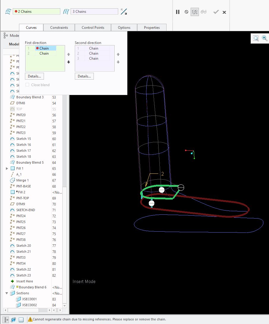

Hello All,
I have an enclosed volume (at least I think I do) after merging all of my quilts. I need to solidify this component and it will not allow me to do so. Any thoughts? See attached.
